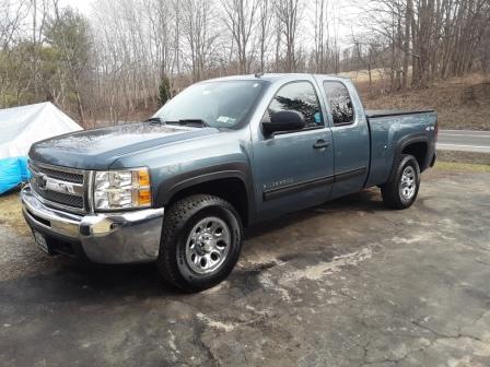

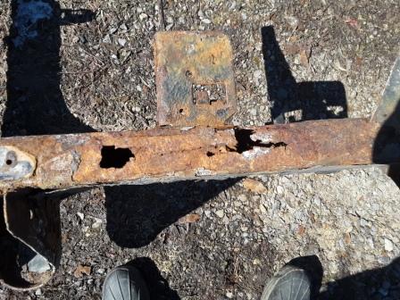

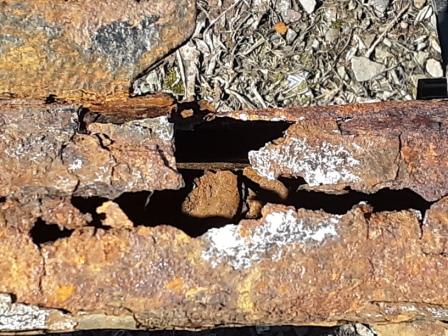

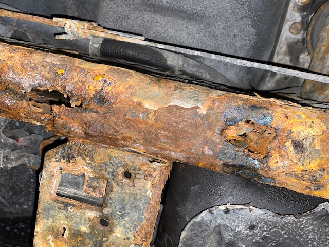

So life took me away, then slapped me upside the head! On 1/21/2021 my 2013 chevy silverado 1500 failed a NYS safety inspection due to severe frame rust through! ... In spite of the fact that when I bought it, I also bought ECP AUTO ARMOR paint/rust protection. As a matter of fact, it was sprayed 3 separate times. Making matters worse, I submitted the claim the same day but because the warranty expired 2 days before, they denied my claim! ... Even though rust through of heavy frame steel just doesn`t happen in 2 days (so the damage clearly happened while under warranty).
Anyway, folks at my garage indicated that due to the condition of the frame, a repair would just be a bandaid, so a search began to find a good used southern frame. after 2-3 weeks, all we came up with were frames too rusty or bent from collisions. I bit the bullet and had them order a new frame from GM.
It may seem nuts to some to put around $8k into an 8 year old truck, but with 50,700 miles, and an excellent engine, tranny, and body, I had little choice as I couldn`t drive it, sell, or trade it like it was!

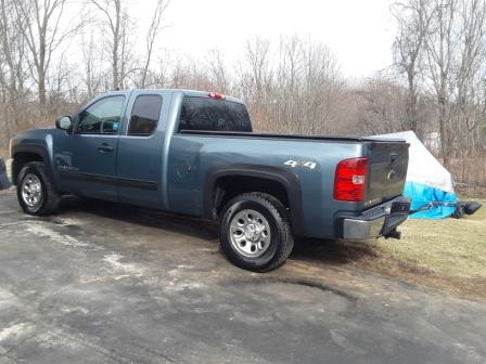

So a new frame was installed or should I say, my truck was tore down and rebuilt on top of a new frame. They did an awesome job and I`m back on the road again...and this time, the frame, axles, under body and inside panels were all well treated with FLUID FILM, that I will update annually.
So with my new, old truck, and a renewed sense of `new car fever`, I`m back here to show `n tell and learn.

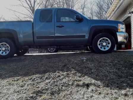

I might point out that my truck had 30,100 miles on it when I bought it and in 6 years I`ve put on 20,600 miles...so it sits in the driveway a LOT. So not a daily driver or a garage queen. But when you look at it, it still looks like a new truck. Note: these truck pictures taken yesterday 3/22/2021...

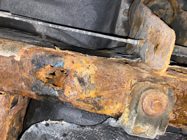

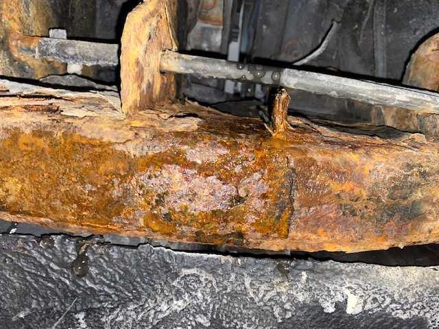

I was reluctant to get the undercoating on a used truck, but was assured that it would protect the truck...yea, sure! So I bought the truck in January and it was sprayed with ECP AUTO ARMOR on 1/19/2015. But in the spring, I noticed surface rust on the frame, so I had it sprayed again. It was sprayed again in the fall of 2017. The product and/or application was an epic failure!
So the damage was discovered just 2 days after the 6 year warranty was up. I filed a claim that same day. The claim was denied even though the damage clearly occurred during the warranty period and my contract indicates I have 60 days from discovery of damage to file a claim. They maintain that they only accept claims if the warranty is still in effect. I filed a complaint with the better business bureau to no avail. I also filed a complaint with the NYS Attorney General`s Consumer Fraud department and they are acting as a mediator.

Wow, that`s incredible damage. It`s a wonder that car was still able to be driven. My little bit of investigation into undercoatings is that they need to be inspected and maintained/touched up yearly. Did they not see the rust at when it was recoated? Apparently, they did not do proper rust mediation and simply applied the coating over the existing rust, they encapsulating it under the coating and making matters terribly worse. I agree, with dgage and get a lawyer as this is 100 incompetence and negligence on the installer/company`s part.
"Did they not see the rust at when it was recoated? Apparently, they did not do proper rust mediation and simply applied the coating over the existing rust, they encapsulating it under the coating and making matters terribly worse."
I`m convinced that there was little if any prep work and they just sprayed over the rust. In addition, I suspect that the product plugged drain holes in the frame allowing rust from the inside out.

footnote: I have since learned that ECP pays subcontractor installers so low that little, if any, prep work is typically done! It was also suggested that inside frame rails went untreated and outside spray may plug frame drain holes so the frame rusted inside out.
