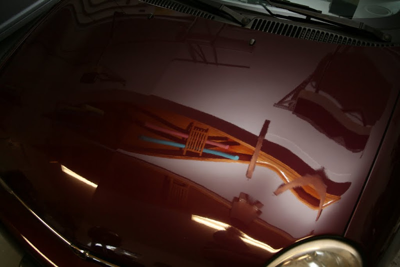

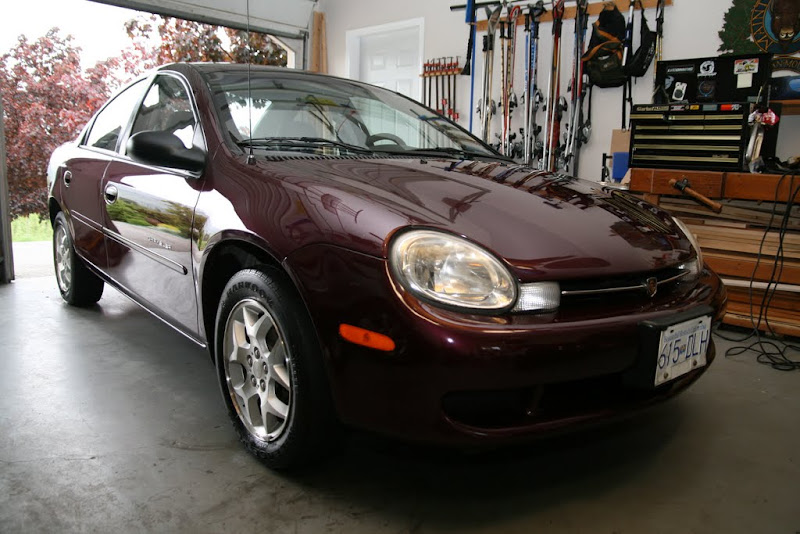

I refinished the paint on a 2000 Chrysler Neon today. The car had been neglected, rarely (if ever) properly waxed, washed with what seems like steel wool, and generally not cared about.
My process was as follows, using a PC7424XP
Poorboys SSR2.5 -- LC Yellow 6.5"
Poorboys Pro Polish w/ Carnauba -- LC White 6.5"
Poorboys EX-P Sealant -- LC Black 6.5"
I fully worked all the products, and let the sealant cure for 45 minutes. No issues with application of removal, Poorboy's makes easy products!
I was warned that the LC yellow and PBs SSR2.5 would be a fairly harsh combo, but as far as I can tell I still needed more... or do I?

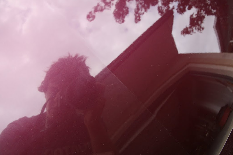

Is it common on older vehicles to come across swirl-like scratches that simply cannot be removed without wet sanding? There is no doubt that all off the fine brush marks, spider webs, fine/medium swirls, and scuffs were removed (you'd hope so after all the work I put in to it!) but when you look at closely in the sun you can still see what LOOK like heavy/deep swirl-patterned scratches in the paint. I can practically feel them with my fingernails.
It was a hundred dollar job, there is no doubt in my mind that they got their moneys worth, Im just curious if there is more I can do? I can't see going from SSR2.5 to SSR3 making that much of a difference. Is this just something you have to deal with on abused vehicles?
It's tough to see what you are describing without a larger picture, but judging by the bottom two pics, they DEFINITELY got their $100 worth. Even for a small car like the Neon, to get a 3-step process for $100 is a deal.
Looks a lot better, can't tell what kind of swirl removal you achieved without lights or sun on the car though.
Honestly, I'd look into Meguiars #105 and #205 for your polishes. Better cut and finish than Poorboys.
I agree with Scottwax: get some Meg's M105/M205 and, from Accumulator's advice, some 4" pads and backing plate with your PC7424XP. Yes, it WILL take longer to polish out the Neon, but you can achieve better results.
By the way, I think the car looks excellent in the photos you've taken, for what it's worth.
Unfortunately, the smaller scratches and some of the random individual deep scratches (RIDS) don't "appear" in your photos, so I am assuming that when you see the car in person, it's appearance does not meet your expectations.
I agree that it looks like they got what they paid for.
One thing I question is how well EX-P "stuck" after having a Carnauba (Pro Polish) layer on the car. I'm no PBW product expert so maybe they have a system that works that way. Most sealants require squeaky clean panels with nothing on them.
Agree with M105/205 and 5.5" pads. SSR3 would likely work too, but it is a very gritty compound and will likely leave a bad haze in the paint requiring multiple polishing steps to follow.

I was also worried about this. I contacted Poorboy's and was assured that since both the PwC and the EX sealer use the same sort of carnauba-esque chemicals, there would be no issues with the sealant bonding.
I've ordered some orange 5.5 inch pads, hopefully that helps. And yeah it was overcast all day yesterday so it was difficult to take a photo of the damage I was seeing.
They could only be described as swirl marks, just very, very deep swirl marks.
