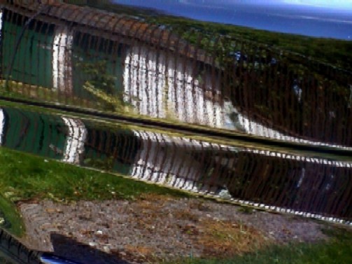

Both good replies for you here, I agree about Blackfire products, even on white I love that stuff! Follow it with collinite 845 and BAM!
That is a very subjective question. What looks best is all in the eyes of the beholder. You will likely get many different answers to that question. Jeff makes a very good point about your background and abilities. The process and technique are just as important as the products used. As far as the LSP goes, I agree that you can't go wrong with BFWD.
